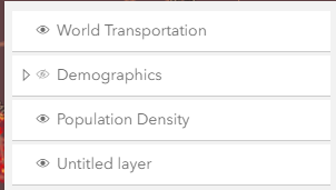

I added GraphicLayer to the LayerList Widget sameple and get "Untitled layer."  I wonder is there a ways to hide "Untitled layer" or hide MapImageLayer.    See code below.

MattDriscoll
Set the listMode on the layer to "hide". See the link below
Layer | API Reference | ArcGIS API for JavaScript 4.3

RobertScheitlin__GISP
MVP Emeritus
James,
   If you add a "title" property to your parcelGL layer then it would not show as Untitled layer.

jamesa
Can you show me how do you add that to the code?

JimNoel
I find that I have to add some code to prevent graphics layers from being added to operationalItems:
layerList.operationalItems.on("before-add", function(event){
  if (event.item.layer.type == "graphics") {
    event.preventDefault();
Whenever layerList tries to add a graphics layer to the list, this cancels that operation.  A bit of a hack, hopefully ESRI will come up with a better way of dealing with this!
MattDriscoll
JimNoel
Ah, that's a much better way.  Thank you!  I wouldn't have thought of looking under Layer properties rather than LayerList for that.
