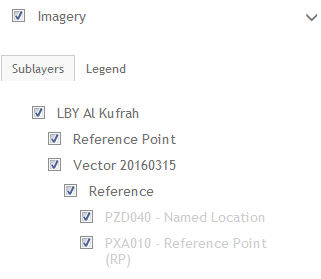

Hi,
I want to add a service with large number of layers to the LayerList widget.
By default all layers are enabled and the whole tree is expanded:
How to restrain expanding to the first level of the tree?
Alternatively, how to disable the fist level what causes branches to colapse?

Michal,
  Sure you can do that through CSS manipulation:

MichalGasiorowski
Robert,
Thank you so much for this solution!
This do the trick and is a great starting point for further development.
As I'm beginner in web programming, please let me learn something and decipher your code, not only copy it:)

RobertScheitlin__GISP
MVP Emeritus
Michal,
  You are not going to find documentation for esri internal workings, so the best way I find is to use my browsers element inspector by right clicking on a dom element and looking at the style tab (in Chrome) and see the classes that are assigned to that element. When the sublayer intially loaded it has these four classes "esriSubListLayer esriHasSubList esriSubListExpand esriListVisible" and when you click on that element it collapses and only has "esriSubListLayer esriHasSubList". So that tells me that "esriSubListExpand esriListVisible" are the classes that cause the sublayer to be expanded.
"esriLayer" class is only assigned to the main layer and "esriSubListLayer" is assigned to sublayer inside the "esriLayer" that should answer your first question.
Don't forget to mark this question as answered by clicking on the "Correct Answer" link on the reply that answered your question.
MichalGasiorowski
Thanks for this explanation. It really shows that being familiar with developer tools is necessary.
I didn't forget, just waited for your final reply:)
