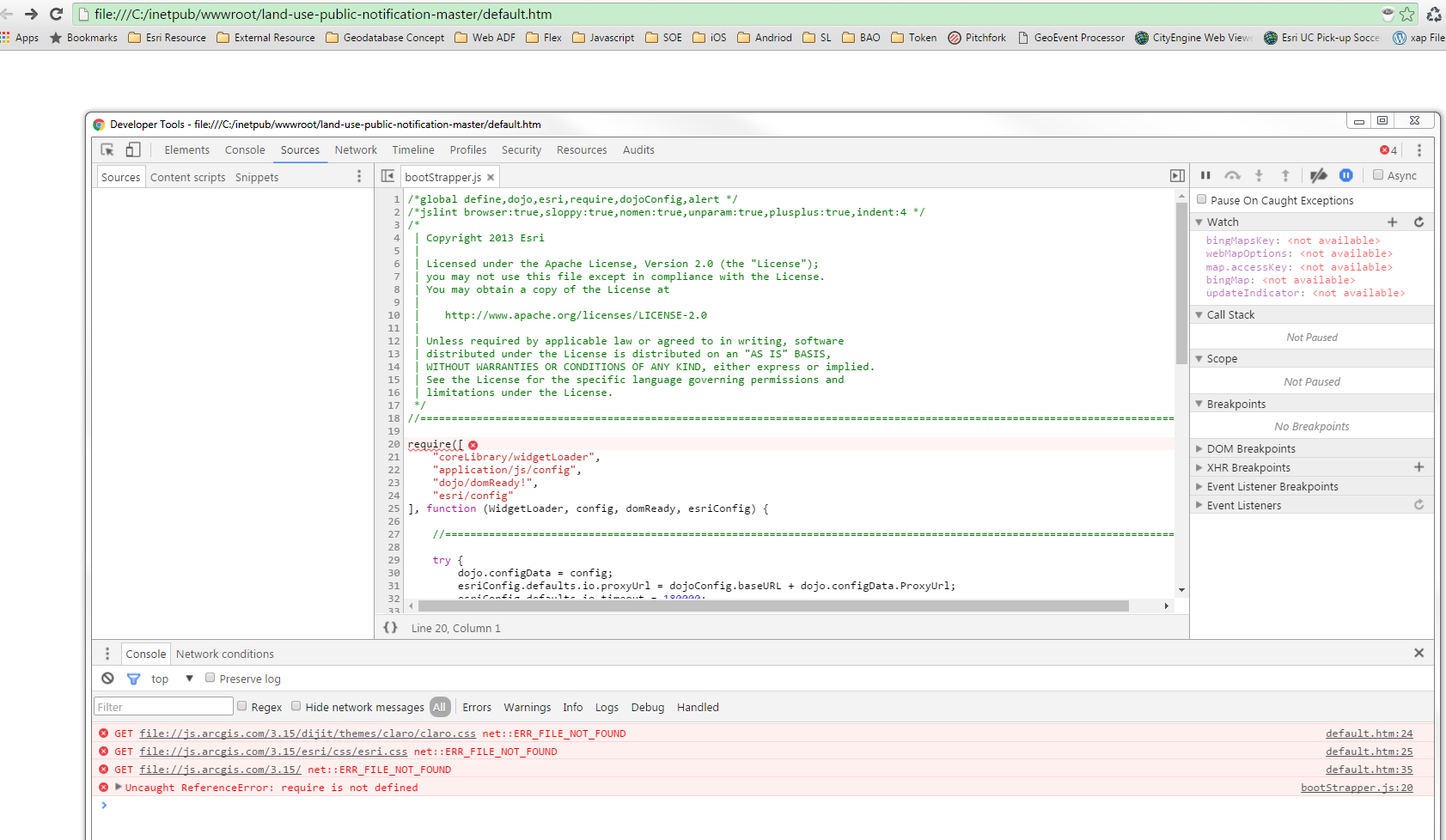

Hello,
I just downloaded the land use public notification. Land Use Public Notification | ArcGIS for Local Government
Is there a reason why I am getting an ReferenceError: require is not defined error in the bootStrapper.js file. I have not made any changes besides the urls. I also got the same data from GitHub - Esri/land-use-public-notification: An application that allows local government staff to ide...  and I still got the same error.
What do I need to change or add?
Thanks,
Jenna

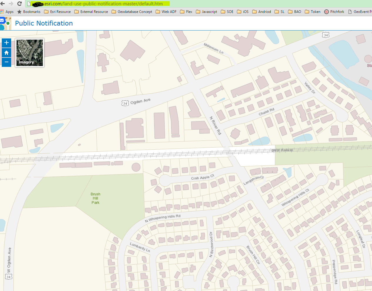

Hi Jenna,
The issue is you directly running the application with the local file path. You need to put the file under your local server folder, for example, the default folder path is C:\inetpub\wwwroot and when you running the app, you should put your localhost or your fully qualify domain. For example: http://yourMachineName.domain.com/land-use-public-notification-master/default.htm Here I attached two screenshots to illustrate my words:
This is wrong path:
This is right way to load the application:

Hi Jenna,
This is wrong path:
