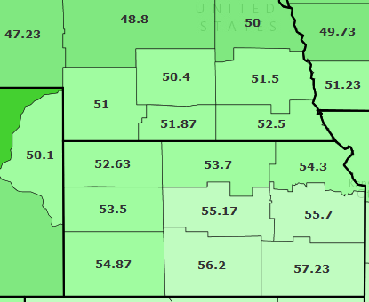

I have a web map with a FeatureLayer (polygons).  I’m using a LabelLayer to label the polygons with a double-type field.  My values in the field go to the hundredth, but some don’t. (example image below)  I want to show all labels with values to the tenth, which means some will have to be rounded, and others will have to be padded on the right with “.0”

Well, I got LabelClass to work, so I've partially succeeded.  However, setting the fieldInfos>format>places doesn't seem to be doing the trick for me.  Here's the code I implemented.  The variables flayer, field and labelCDvSymbol are defined earlier in my code.
var labelsCDs = new LabelClass({labelExpressionInfo: {"value": "{"+field+"}"}, minScale: 10000000});
labelsCDs.fieldInfos = [{"fieldName": field, "format": {"places": 1}}];
labelsCDs.symbol = labelCDvSymbol;
console.log(labelsCDs);
fLayer.setLabelingInfo([labelsCDs]);
The labels show the correct field and font/symbol, but they're still just not rounded/padded to the tenth.  I can see in the console that the fieldInfos>format>places has been set to 1.
