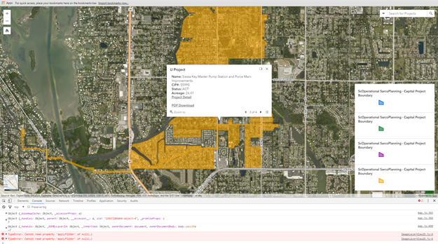

I have just discovered that when I added an ImageryLayer to my view through the basemap toggle and activate it, then click on my feature layer, paging tools become active on the popup:
paging tools are not active when the topo basemap is active, similar to the post above.  I haven't specifically defined the Popup widget.  Clearly the popupTemplate can display paging info, is there a way to define paging info yet?

It is possible for the Popup to page multiple features. The only thing is the view doesn't handle it automatically just yet. We still have some work to do there.
But, you can do this if you have the features that you would like to show:
Popup.open({
features: [],
location: Point()
Then it will show multiple features that location. Each feature can have a PopupTemplate that defines how it is displayed.
