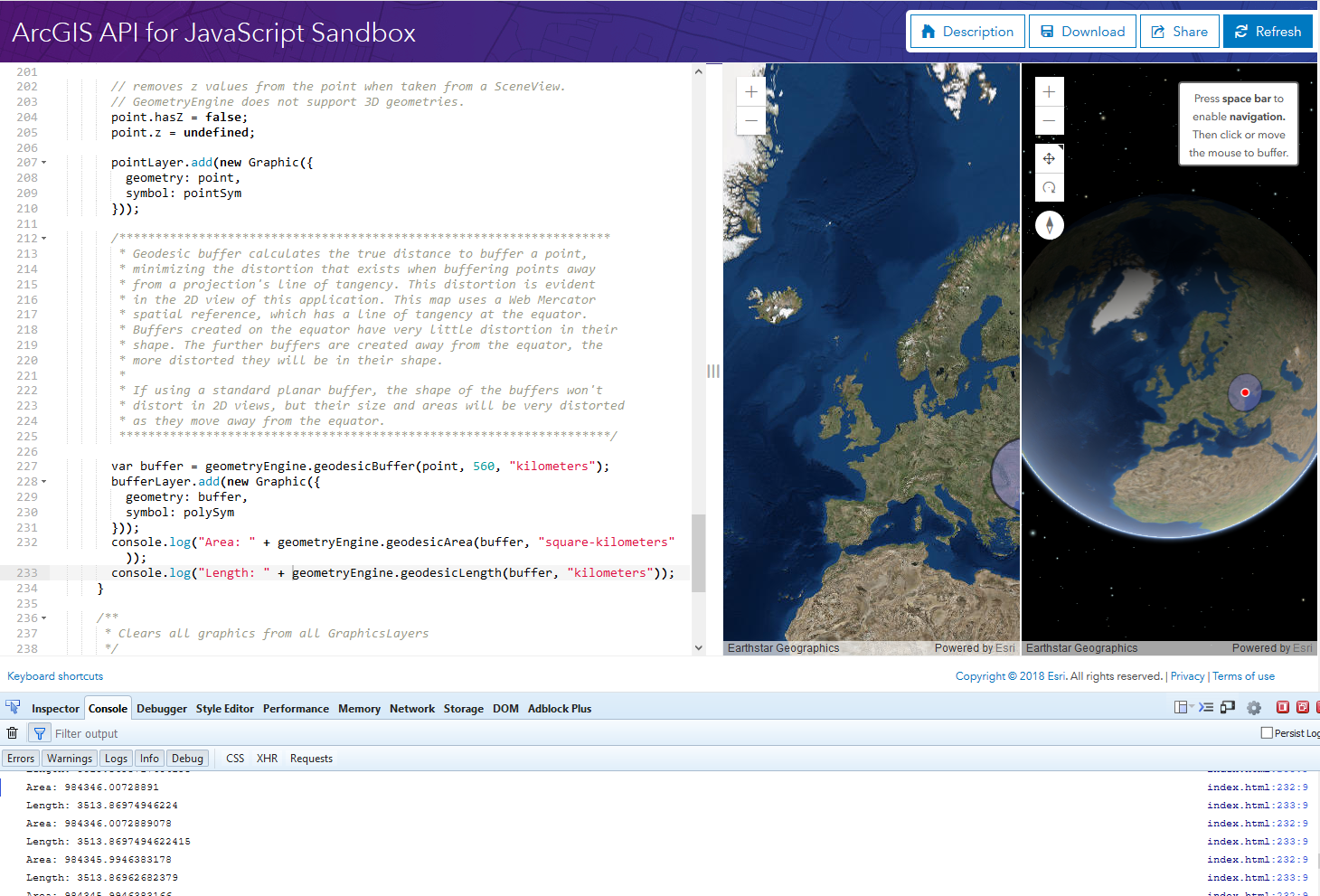

That function works properly in the geometryEngine sample GeometryEngine - geodesic buffers | ArcGIS API for JavaScript 4.6

TubaKumbara
ok. i found solution. This is works. send graphics.geometry instead of graphic.
Thanks.
