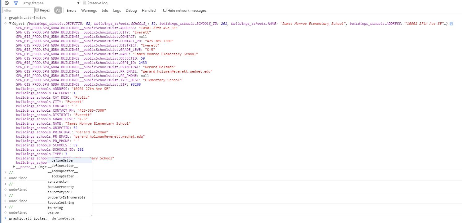

I published a service with an SDE feature class that also includes a joined table for that feature class. When my infoWindow content function fires off, the attributes for both the feature class and the joined table are "there" but they can't be accessed. Anyone have a clue with this one?
Normally, you can type graphic.attributes.<attribute field name> and get the values but, as you can see in the screenshot, this isn't the case here. The service is internal so I can't link out to it here, unfortunately.

Have you tried graphic.attributes["<attribute field name>"] like this?

Yay! We have a winner, thanks.
I had been trying graphic.attributes[0] but that wasn't working. Didn't think to try the variant you suggested.
