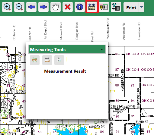

My question is, what should I look at to correct these issues.  Here is a screenshot of the button that fires the floating pane and the floating pane that contains the measurement widget:

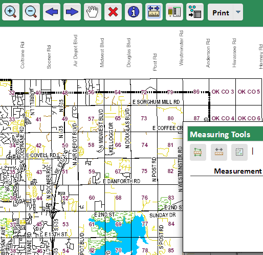

After closing the pane, then reopening (repeat step a couple of times).  Notice how the pane shifted to the right and down and part of it is cut off on the map:

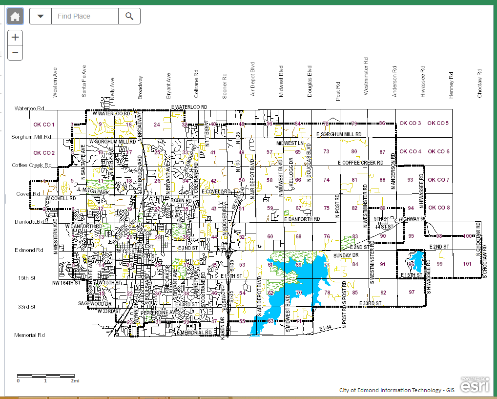

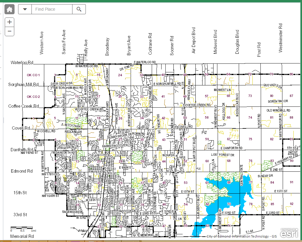

Also when the map first loads, here is the extent (not the initial extent I set):
When I hit the home button twice (notice the map goes to full-extent my set initial extent):
