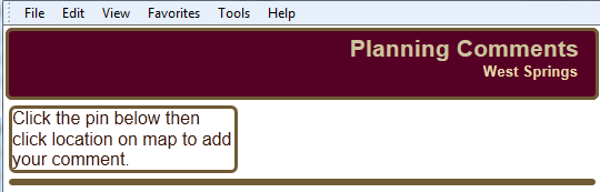

Hello everyone,
I have the attached file (AddRecord_V6.html) which I will paste into the thread at the bottom. It works fine in the JavaScript sandbox environment. I have recently tried to break this file out into separate files (.html, .js, .css) to see if I can get this working from the web server on my PC (localhost).
Of course it's not working. What I see is:
I'm confident that 2 things that need to be changed when moving away from the Sandbox environment are:
  1. Proxy
    • I have been trying to follow (https://developers.arcgis.com/javascript/jshelp/ags_proxy.html) to get the proxy working. But I'm not getting it. Is there any documentation that can help walk someone more explicitely through the steps?
    • Irregardless, I don't think that the proxy issue would have anything to do with the map not displaying above.
  2. Dojo
    • I've been reading on the dojo site dojotoolkit.org, trying to get that set up. The easiest method seems to be to reference a CDN.
Basically I don't know what I'm missing to get this working. Any direction greatly appreciated. The index.zip contains the individual files broken out. Below is the code from AddRecord_V6.html
Thanks all!

Chris,
  Just add the JS API script to your index.html:

ChrisHolmes
Thanks Robert. That seemed pretty simple. It works fine in Chrome. In IE it will not open the form or put a point on the map when I click to add a new point, I believe this is where the proxy is required?? I am using IE 9 (which I thought it would work fine with, I thought the Proxy was needed only for older browser versions)?
Thanks for your help,
Chris
RobertScheitlin__GISP
MVP Emeritus
Chris,
   It works fine on my local web server using IE11 (I don't have access to IE9).
