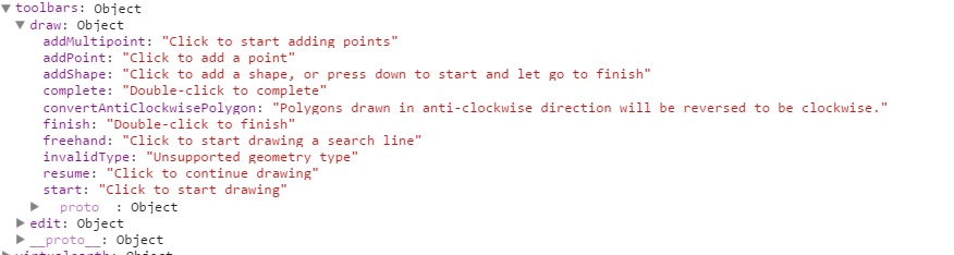

I was just trying to research this looks like you have following options:
To view all the customizable widget strings view any of the samples in a browser with debugging tools open and type console.dir(esri.bundle) in the console.
Tim Witt‌ is partly correct you can access the element and apply the tool tip.
Here is a hack that I did in the code it uses
on(document.getElementById("dijit_form_Button_2_label"), "click", function(){
  esri.bundle.toolbars.draw.freehand = "Click to start drawing a search line"
FOR THE FULL CODE USE FOLLOWING as SAMPLE:
