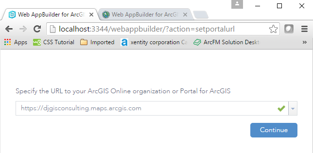

Dave_J_Zhang
Hi, Robert
  Thank you for your responding, I try your suggestion and I successfully logged into my account at the beginning it ask for url and appid I tried to enter app id I created on ArcGIS online it always give me error, then I create through share As and make real web app with template select, and try to enter the new app id, and now it end up with there is no longer has place to enter app id, just a textbox for url and a continue button, when I enter url and click continue button and I got the same error like before, said, invalid client id error 400
see the attached screen shot. What I did wrong here, please help.
Dave
RobertScheitlin__GISP
MVP Emeritus
Dave,
   If you have entered a incorrect AppId when you first had a chance to do so then you can simply delete the signininfo.json Go to your [install dir]\server\ folder and delete the signininfo.json and restart your WAB.

Dave_J_Zhang
Thank you guys to help, I tried all the above, still got same problem, Robert sugguested delete the signinfo.json it is helpful, and does let me to re-enter the appid in the sign in page of web app builder, I assume the app id is the webapp id I created in my arcgis online account, but I still get the
Invalid client_id
Error: 400
I saw related post said start node.js, but I don't know how to start node.js. My machine is 64 bit, I double click node_x86, and run start up batch file. and type webappbuilder address. Did I do the right step?
Dave
MVP Emeritus
Dave,
  node_x64.exe is for 64 bit machines but you should not have to manually start node as the startup.bat does this for you. The invalid client_id points to an inproperly registered app. You should review this page on registering your app to allow WAB access to your portal:
Get started—Web AppBuilder for ArcGIS (Developer Edition) | ArcGIS for Developers
I told you to use localhost in the Url address to get WAB running, but using your actual machine name would be better and use the same machine name (i.e. http://[yourmachinename].:3344/webappbuilder) when you register the app using the instructions in the above link.
