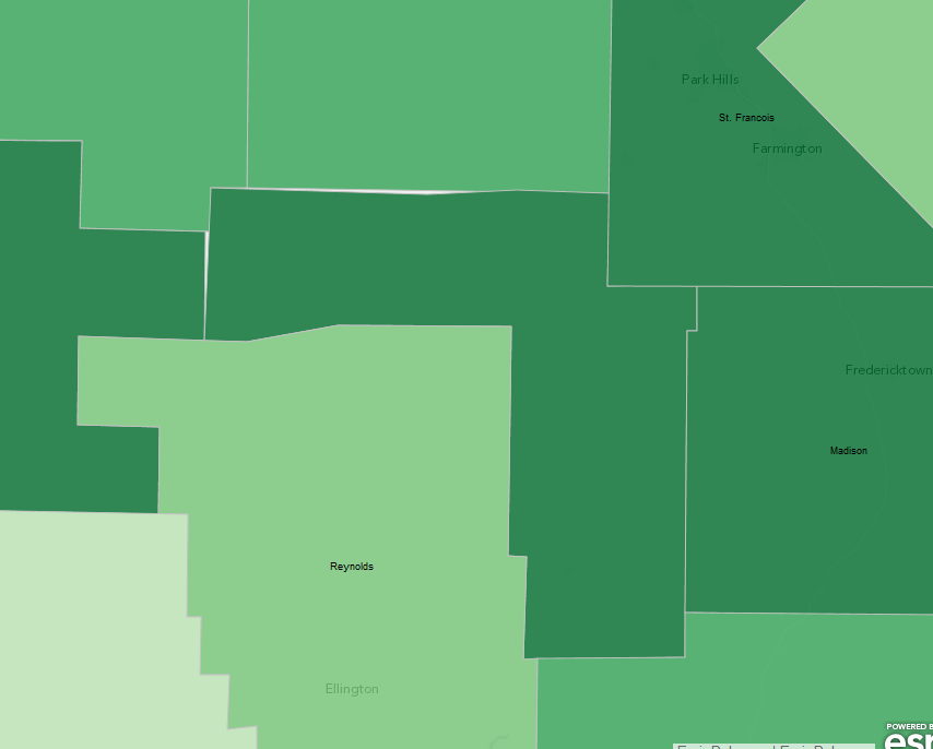

I'm experiencing a similar problem.  I've looked through the reference, but I don't see anything that lets you place overlapping labels.  When I noticing is that no matter how far I zoom in, I have at least one label that never does draw.   These are my county boundaries, which I use all the time, so I can't imagine there is anything wrong the layer itself.  This county is shaped a little differently, sort of an upside down L.  I wonder if the labeling for polygons is based on extent.  In this case the center of that extent doesn't fall within the polygon itself.  The county name is Iron,  so it's not like its a long name!
It seems like a bug to me.  I'm using version 3.10 of the API.

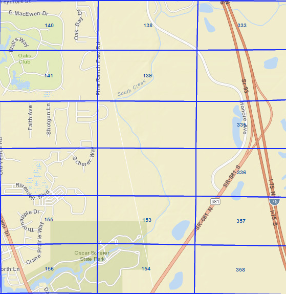

There's something going on with the algorithm.  I'm getting the same thing.  A very simple case below shows a label layer applied to a half-township section grid. I am also at 3.10 and still get missing labels, regardless of various parameter changes I've applied
