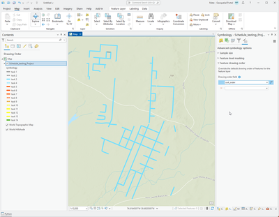

This how we see the layer in ArcGIS Pro;

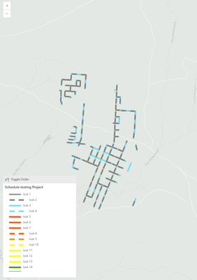

This how it is visualised in JS API with dashed lines;

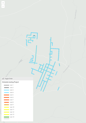

if I switch to solid lines, it is being rendered corrrectly;
