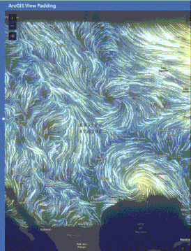

I am working on building an application with Calcite and am wanting to create a collapsible sidebar similar to the sidebar tool in experience builder. I have looked through various documentation in the JS API and Calcite and am not finding a similar component to this. I have built the rest of my app with these frameworks and am wondering if there are any components I can use to mimic this?
I am currently using an action bar for desktop but would like my app to adjust to an adjustable sidebar when in mobile view to select widgets.

There's not a specific component for something like this as far as I know, but you can put one together. I just did a blog post on this in regards to using it with view padding.
https://odoe.net/blog/view-padding
