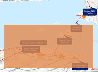

I'm trying to filter a layer based on an extent. Every feature that is in the extent should be loaded/displayed, the rest shouldn't.
Example from the screenshot below: Only the labels with the "origin" point inside the orange polygon should be displayed. "Richtung Pfäffikon SZ" and "Richtung Zürich / Meilen" should not be displayed. 
I think this would be possible with adding an attribute on these items' table, right? My problem is that this should be dynamic and I don't really want to go add this attribute/add a value for around 1M items in total.

Welcome! When executing a query, you can specify geometry to use as a spatial extent (intersect) for the results. Here's a sample.

Though, the other features still show up. As far as I understand I already receive them in the "map image". How can I filter it before it even renders in the gis service?
