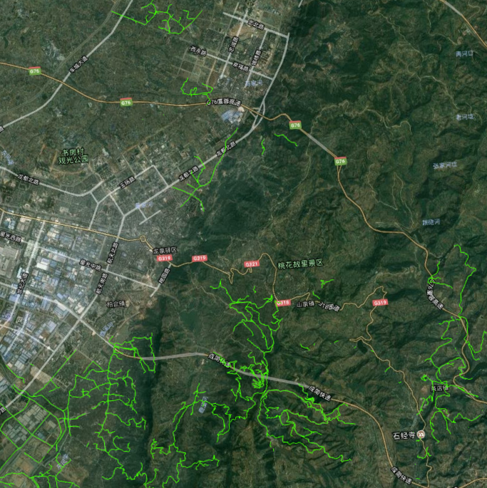

and I get this picture
error picture with some path lose
you can find some path dismiss.with error in chrome:
init.js:288 [esri.views.3d.layers.graphics.Graphics3DSymbolLayer] LineSymbol3DLayer geometry failed to be created (no paths were defined)

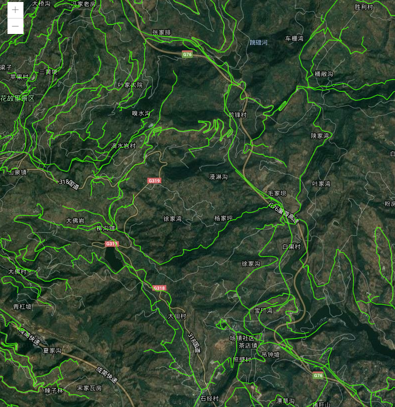

but,when I change it to 2D View,like this:
var view = new MapView({
container: "viewDiv", // Reference to the scene div created in step 5
map: map, // Reference to the map object created before the scene
zoom: 4, // Sets the zoom level based on level of detail (LOD)
center: [0, 30] // Sets the center point of view in lon/lat
It's ok like this:
the right picture
so ,you can find many path than 3D View.
Is it a bug for 3DView?I try to change to no ground,but it still exists,Why,and how can change it?
