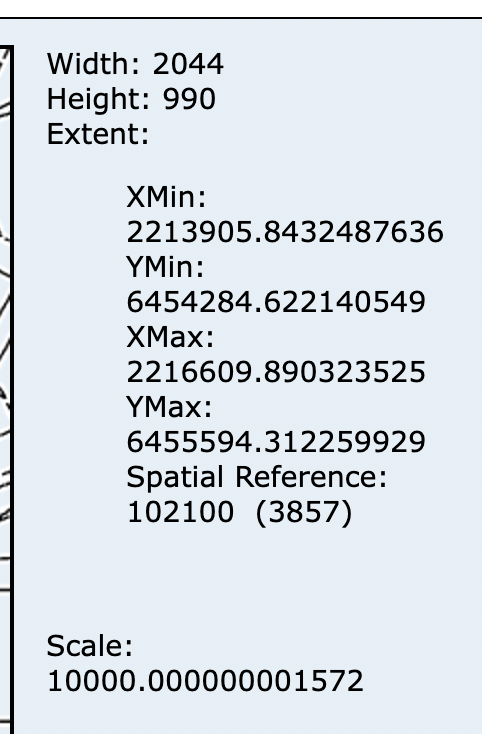

Case 1 (Browser Zoom 100%):
Map scale: 1:10000
Export map calculated scale: 10000.000000001572
Export map link: Export Map Case 1

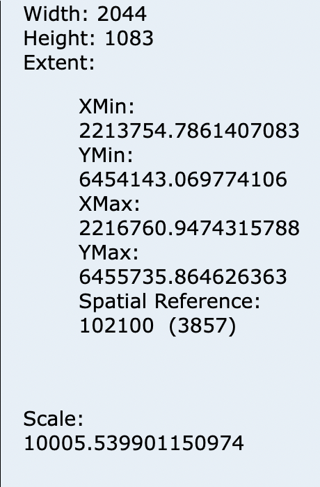

Case 2 (Browser Zoom 90%):
Map scale: 1:10000
Export map calculated scale: 10005.539901150974
Export map link: Export Map Case 2
