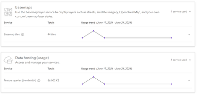

There's a distinct difference in developer dashboard between a developer account attached to an AGOL account and the developer dashboard for a purely developer account (e.g Esri Platform).
When using the developer account (Esri Platform) you should see usage statistics against an API key:
Example:
This information isn't presented in our other developer dashboard account which is linked to AGOL.
Not sure if it applies to your situation but thought worthwhile sharing.
