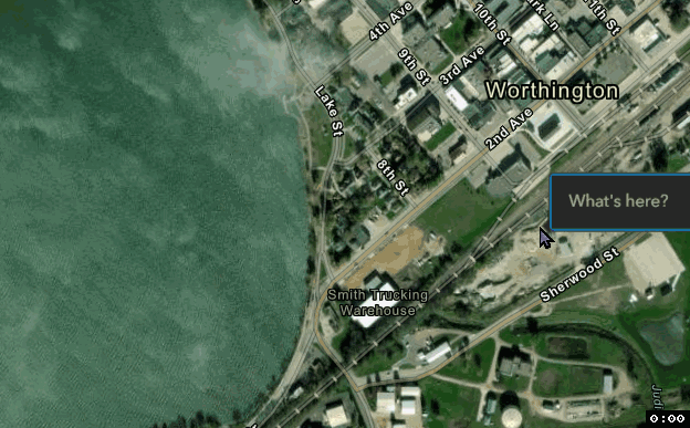

Here's an example on how this could be implemented with a button in the view (based off the Intro to popups sample ) :https://codepen.io/laurenb14/pen/QWoRRpj?editors=1000
The workflow goes something like this:
  1. Watch when the MapView click event occurs.
  2. Check if the right button was clicked and add a graphic to the map where the user clicked.
  3. Display a button or tooltip to open the popup with the information from the reverse geocoding using the MapView.openPopup() method.
You can always implement some sort of clickable tooltip to display at the clicked location as well.
Hope this helps!

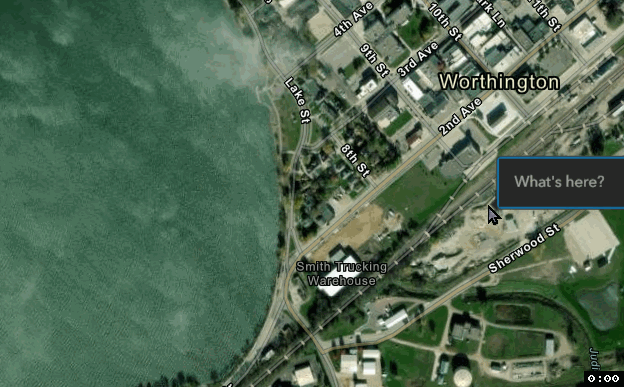

Hope this helps!
