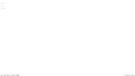

Hi, I'm trying to display graphics on a client side feature layer using class-breaks renderer and picture-marker symbol. Symbols (or images) are getting chopped. Does anyone know why?
Thanks!
