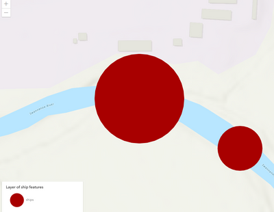

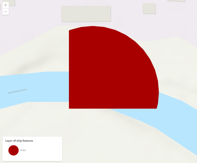

Screenshots:

Hi, glad to hear the conversion from SVG is working well for you!! The cut off issue you are running into is a known limit right now unfortunately. It happens when you use a size visual variable based on real world sizes (lines 273-275 in your codepen). At larger scales, the symbol becomes too large to render properly with our current implementation. This is why you only notice cut off when zooming in to large scales, but don't notice it when zooming out.
A workaround for this could be to set a maxScale on your MapView so that users cannot zoom in to scales where the symbols get cut off.

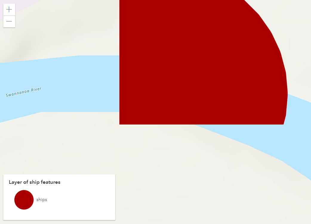

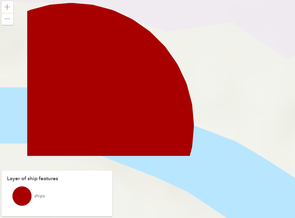

I'm still having issues with the CIM symbol image clipping when using the size override.
I made a codepen with the ArcGIS js api version 4.27 : https://codepen.io/michaelk95/pen/wvpgzaR?editors=1010
When zoomed out:
When zoomed in:
