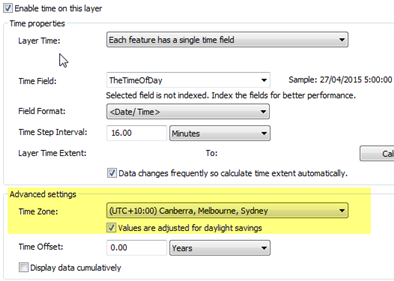

I originally published the temporal layer with the correct time zone for the data.
Publishing this to an ArcGIS for Server 10.3 instance, I can see that this has flowed through to the REST endpoint:
The Time Extent of the time data, is 5am to 10am on 27/04/2015, AUS EST.
So the above UTC time is technically correct.
