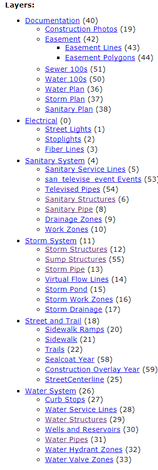

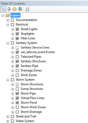

I'm confused on how I can use dynamic layers in the 4.4 api. I have a group of layers published from arcmap like this:
By default, all of the group layers are off, some of the child layers are on, and nothing is visible until the user toggles a group layer on. (this is how it works in 3.x).

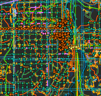

When the map loads, all of the child layers that are visible are displayed. The map looks crazy busy.

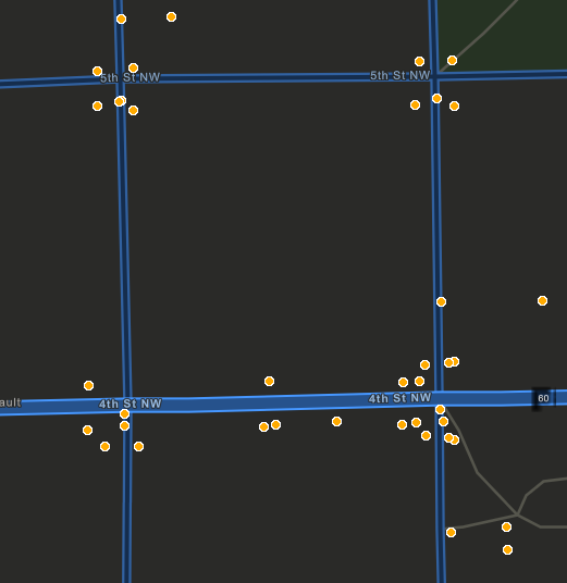

So just to test what happens I uncomment the above code to show only sublayer 12.
This works, only sublayer 12 is shown:

In the version with no sublayers, the network image request looks like this:
layers:show:43,44,51,50,36,37,38,1,2,3,53,54,6,8,9,10,55,13,14,15,16,17,22,58,59,25,30,31,32,33

The JS code then looks at this information and see that there is no sublayer with id 12
There is a sublayer id 12. Its the storm structures layer.
