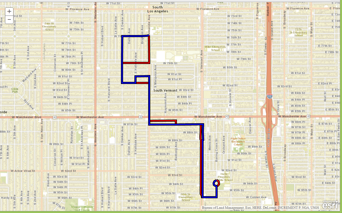

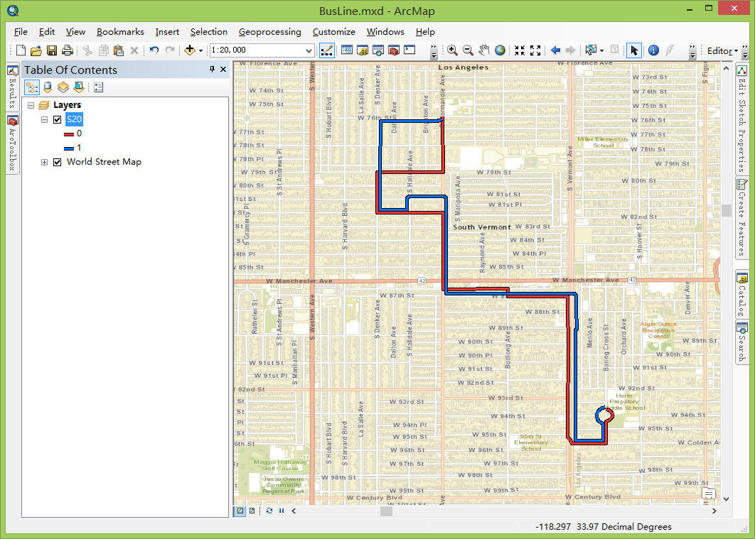

Hi, I have a routing layer with lots of bus route.  In order to distinguish the collinear route, I used offset property in arcmap line properties.  But how to show the same effect on a web map?  Since the route is dynamic solved by route task, it may be not suit to publish a map services.  Is there a way to set the symbol of a graphic?
The mapping result in arcmap:
The webmap I've tried:
The JS Code:

I think you can only set offset for Point geometries by means of the graphic object definition.
For the Polyline graphic you could iterate through the line path and specify an offset for each coordinate:
var g = routeLayer.graphics[1];  // red line
var offset = 0.0001;  // decimal degrees
for (p in g.geometry.paths){
  var path = g.geometry.paths
  for (pnt in path){
    var xy = path[pnt];
    xy[0] += offset;
    xy[1] += offset;
routeLayer.redraw();
