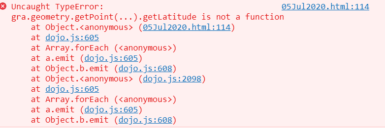

var LatLon = String(gra.geometry.rings
console.log(LatLon);
latlon = LatLon;
The error that I get when I debug I get an error that states that getLatitude() is not a function.
Please assist.

OK, I was mixing 3.x and 4.x code. In 4.x there is no getLatitude function, it is now just a property of the point.

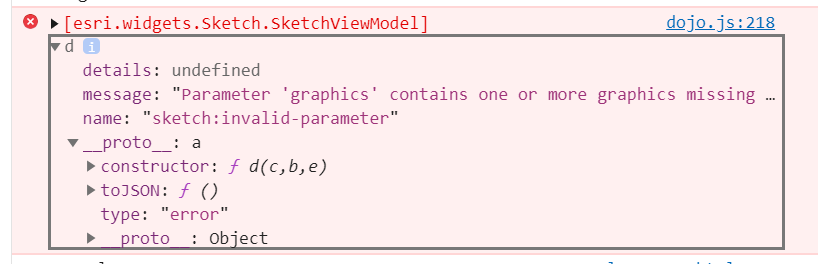

The new error you were getting is because you were removing the graphics with event.graphic.layer.removeAll(). this was an issue as you are asking the sketch widget to update the drawn graphic immediately yet you removed it and replaced it with a clone.

You need to use getPoint method on the polygon.
for (var i = 0; i < gra.geometry.rings.length; i++){
  for (var p = 0; p < gra.geometry.rings[i].length; p++){
    crmLatitude = String(gra.geometry.getPoint(i, p).getLatitude());
    crmLongitude = String(gra.geometry.getPoint(i, p).getLongitude());
    var LatLon = String(gra.geometry.rings[i][p]);
    latlon = LatLon;
SiyabongaKubeka
Hi Robert,
I did use this way but I still get the error that says getLatitude() is not a function.

RobertScheitlin__GISP
MVP Emeritus
That is a new different error. How about we do the reverse as I am the one providing the help. You provide your code or a sample you are having trouble with.
SiyabongaKubeka
Hi Robert,
No problem, here is my code:
            if (event.state === "complete") {
              if (view.zoom >= 11) {
                let gra = event.graphic.clone();
                //event.graphic.layer.removeAll();
                event.graphic.symbol.color = "red";
                //gra.layer.add(gra);
                console.log(view.zoom);
                console.log("X = ", gra.geometry.centroid.x);
                console.log("Y = ", gra.geometry.centroid.y);
                console.log("Lat = ", event.graphic.geometry.centroid.latitude);
                console.log("Long = ", event.graphic.geometry.centroid.longitude);
                lat = event.graphic.geometry.centroid.latitude;
                lon = event.graphic.geometry.centroid.longitude;
                zoomLevel = view.zoom;
                for (var i = 0; i < gra.geometry.rings.length; i++) {
                  for (var p = 0; p < gra.geometry.rings[i].length; p++) {
                    var pnt = gra.geometry.getPoint(i, p);
                    crmLatitude = String(pnt.latitude);
                    crmLongitude = String(pnt.longitude);
                    var LatLon = String(pnt);
                    console.log(crmLatitude);
                    console.log(crmLongitude);
                    latlon = LatLon;
              } else {
                alert("please zoom in");
                event.graphic.layer.remove(event.graphic);
