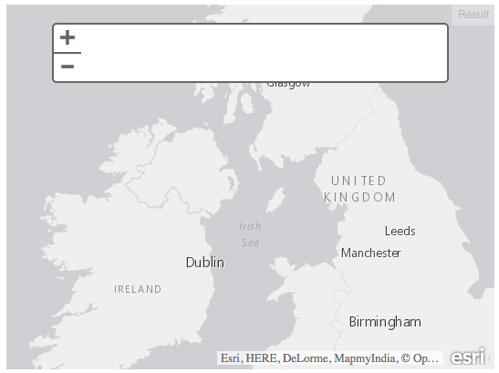

I've got a map dijit - by default the simple zoom slider (+/-) is in the upper left corner. I want to place it in the upper right corner. According to the documentation I can use this in my CSS:
.esriSimpleSliderTL {
    top: 50px;
    right: 50px
Unfortunately all this does is stretch the zoom slider. Like this:
Try it here: http://jsfiddle.net/bEwcD/3/
How to I get that zoom slider 50px by 50px from the upper right?
TIA

Dirk,
  you have to unset the left constraint.
    right: 50px;
    top: 50px;
    left: unset;

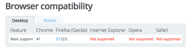

Close but not quite there yet. Turns out that unset is not supported in IE, Safari, and Opera.
unset - CSS | MDN
