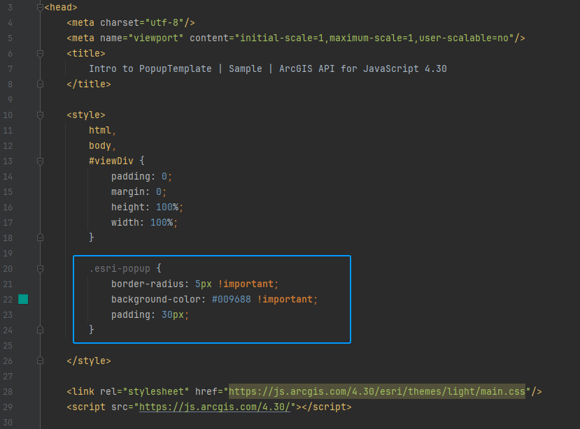

When using the ArcGIS JavaScript API in AMD mode, I could modify the default Popup styles by adding the following code to my CSS file, as shown in the screenshot below:

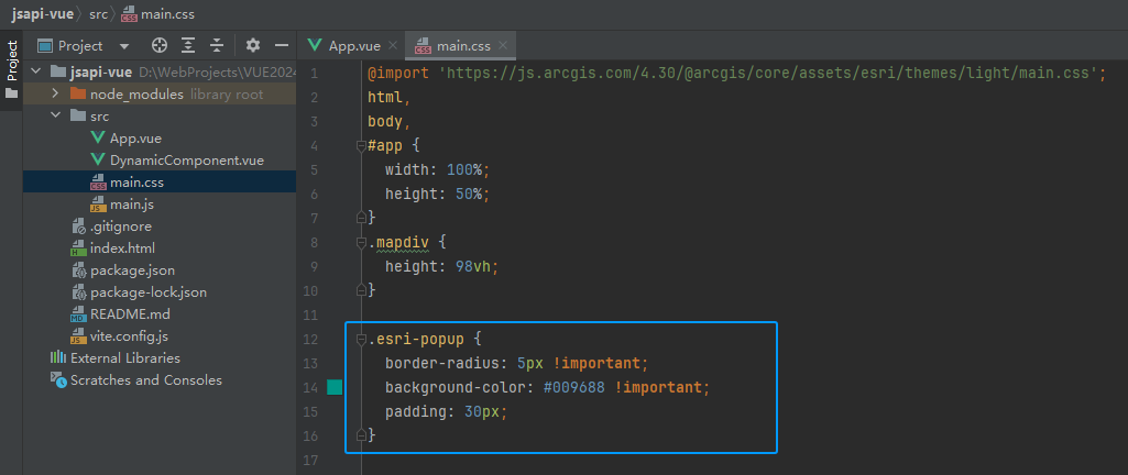

However, when using the ArcGIS JavaScript API in ESM mode, adding the same code to the CSS file does not take effect, as shown in the screenshot below.
Does anyone know the reason for this? When using the ESM version, how should I modify the Popup styles to make it work? Thank you!
Lerman
Changing the import “. /main.css” from the <style> tag to the <script> tag will successfully apply the `.esri-popup` CSS

Lerman
