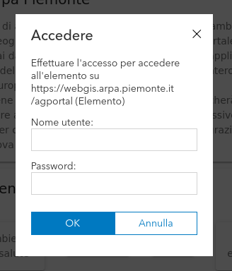

 Then the login windows is opened:
And all works fine, I insert my credential and I can work with it.
