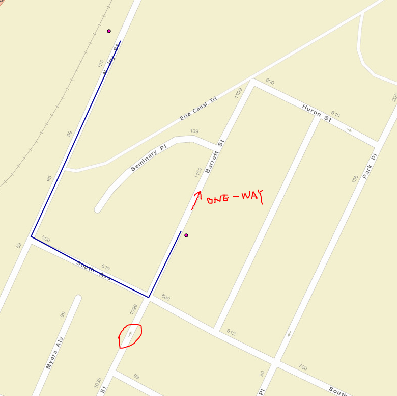

All,
   I'm using esri javascript api 3.20.
   I want to implement an ONE-WAY restriction for route analysis.
  The network server (NAServer) has an attribute "Driving a Passenger Car". (TomTom North America data)
  In arcmap, the results are as expected.
But when using esri js api, the results was
How to apply the one-way restriction?

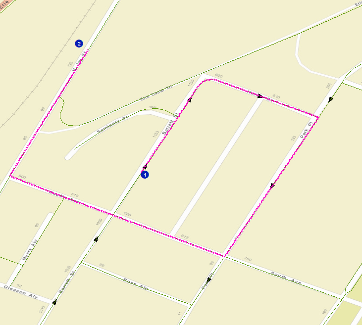

LeoDeng
I'm trying to use travel mode option, but the result is same as before.
