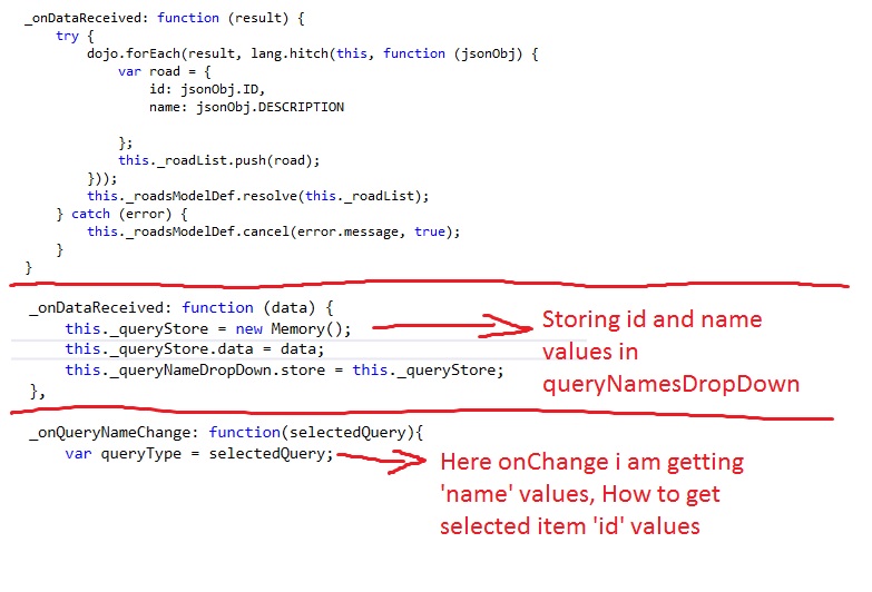

I am populating combobox using web api 2 odata service using dojo, But here i want to know how to get selected 'id'.

I usually directly use the dropdown's item property. It will return the object associated with the selected index.
var selectedItem = this._queryNameDropDown.item;
id = selectedItem.id;
Hope this was helpful.
