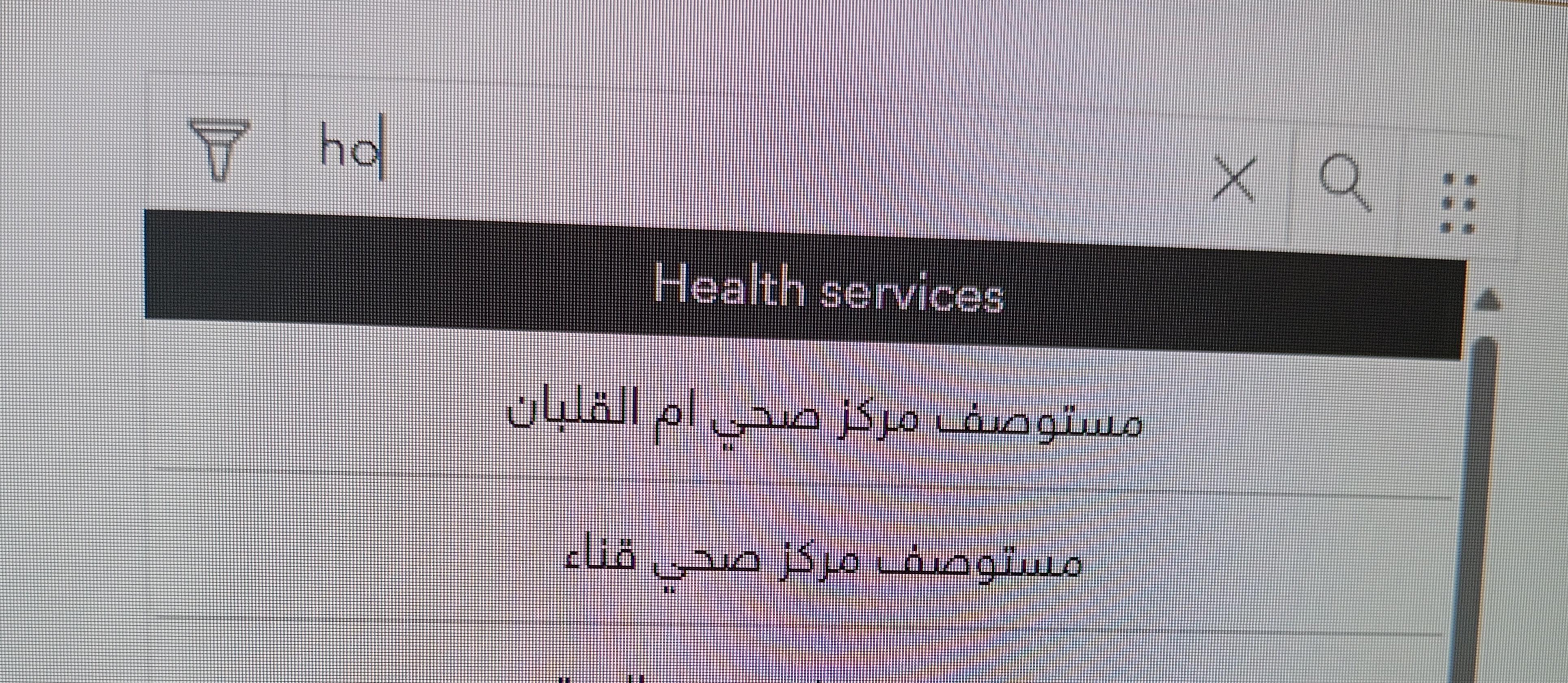

I got a problem in search widget which is when searching the displayed field for the suggestions does not match the field matched with search term.
Is there a way to handle it using displayField or suggestionTemplate property?

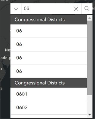

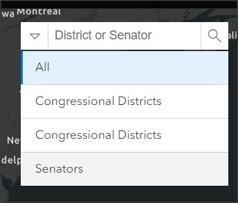

AMostafaH
If I did so, the same layer will appear many times in the suggestions list and I don't want that to happen.
I believe the best way is to use suggestionTemplate property and add all fields used in the searchFields property.
I will attach pictures for your scenario.
