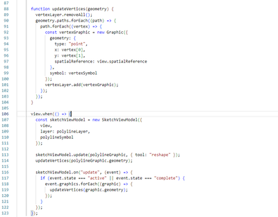

I wanted to change the vertex of the polyline but i didnot find any way to change the vertex of the polyline. Anybody have any idea how to do this.
here is my code in codepen
https://codepen.io/ayaxcphb-the-decoder/pen/ByaLRJq
Thank You!
MirzaMuhammadAhsanAli
I change the vertex using two graphic layers one for polyline and other for custom vertex, may be it is not the best way to do it, but for now it is the only way i can find to do this.
here is the code in codepen
