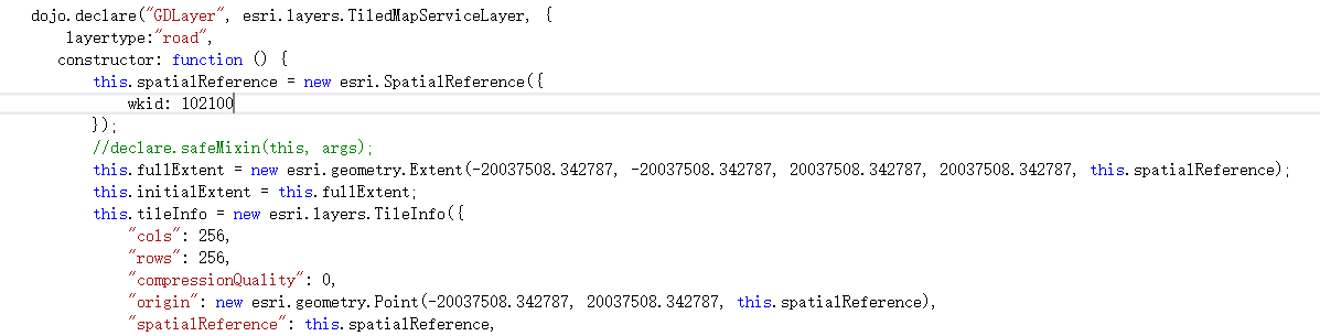

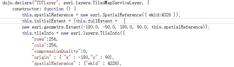

  I want to load two tiledMapServiceLayer with different spatialreference.But when i load one layer successfully,another layer would be loaded unsuccessfully.Here is the code of the tiledMapServiceLayer.
MapServiceLayer1.js
    Part.declare
    Part.getTileUrl
MapSerivceLayer2.js
     Declare:
code for change two layer:
