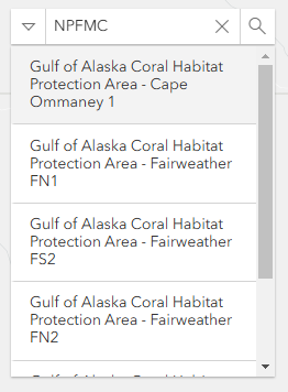

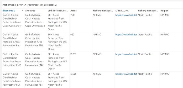

In this (hopefully) reproducible example, my search field is "Region". The search shows values of the first field of the table, that being "Sitename L". Is there a way to change the suggestion?
let searchWidget = new Search({
  view: view,
  maxSuggestions: 6,
  sources: [
      layer: fish,
      searchFields: ["Region"],
      zoomScale: 500000,
      maxSuggestions: 6,
      suggestionsEnabled: true,
Search:
Table:

Yes, you can accomplish this by assigning a value to the suggestionTemplate property.  You'll also want to set the outFields property to ensure that values for any fields you use in the template are being returned.
