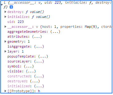

Actually this is my feature I am retrieving:
and then when I try this:
view.popup.open({
    features:feature,
    location:feature.geometry
I am getting this error:
Please help me with this.
YObaidat
you need here to pass "centroid" to the location property
view.popup.open({
    features:feature,
    location:feature.geometry.centroid
