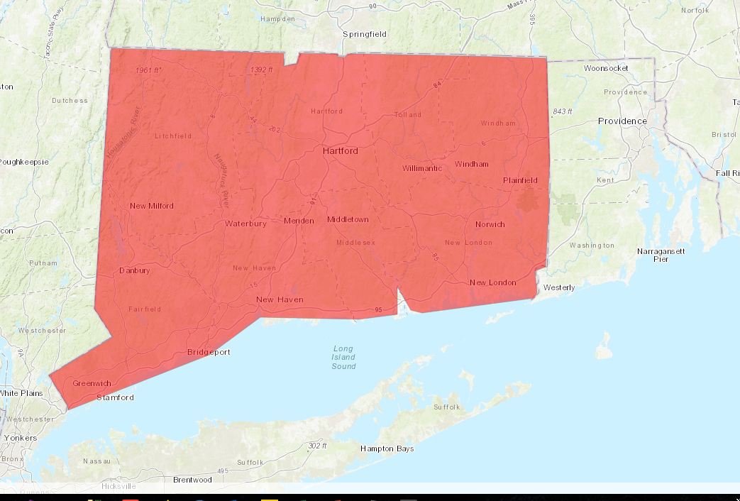

Can you tell me  is there is any way to remove the highlighted area automatically !! how can i remove the highlighted area automatically which appear on screen after choose any option from drop down.
Here is the picture
RobertScheitlin__GISP
MVP Emeritus
irtizahussain
yess but i didn't get how to do this!!
MVP Emeritus
Irtiza,
   Hmm not sure how much simpler I could make it.. Remove the onchange property.
