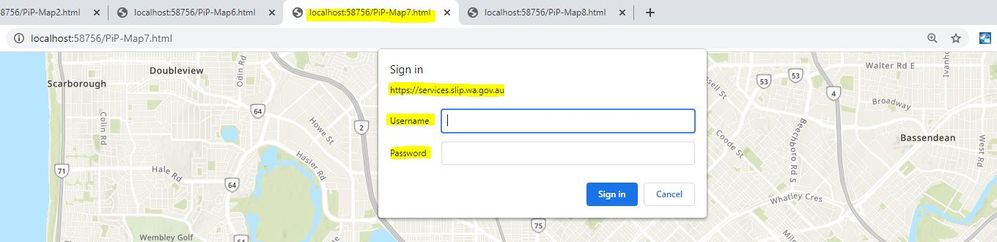

Thanks @UndralBatsukh for the reply. We're using JS API version 4.18 and unfortunately it is still asking for the credentials. Am I doing something terribly wrong here ?
Following is our code:-
<!DOCTYPE html>
<html>
<head>
    <meta charset="utf-8" />
    <meta name="viewport" content="initial-scale=1, maximum-scale=1, user-scalable=no" />
    <title></title>
    <style>
        html,
        body,
        #viewDiv {
            padding: 0;
            margin: 0;
            height: 100%;
            width: 100%;
    </style>
    <link rel="stylesheet" href="https://js.arcgis.com/4.18/esri/themes/light/main.css">
    <script src="https://js.arcgis.com/4.18/"></script>
    <script>
        require(["esri/config", "esri/Map", "esri/views/MapView", "esri/layers/FeatureLayer"], function (esriConfig, Map, MapView, FeatureLayer) {
            esriConfig.apiKey = "AAPK9c1060b46848481f85233a3e75........-......._hEZz";
            const map = new Map({
                basemap: "arcgis-topographic" // Basemap layer service
            const view = new MapView({
                map: map,
                center: [115.860299, -31.954594], // Longitude, latitude
                zoom: 13, // Zoom level
                container: "viewDiv" // Div element
            const featureLayerUrl = "https://services.slip.wa.gov.au/arcgis/rest/services/Landgate_v2_Subscription_Services/Cadastral/MapServer/41";
            //const featureLayerUrl = "https://token.slip.wa.gov.au/arcgis/rest/services/Landgate_v2_Subscription_Services/Cadastral/MapServer/41";
            var layer = new FeatureLayer({
                url: featureLayerUrl,
                customParameters: {
                    "token": "nXKRnEHxOLrfCyVAs3......_....."//Get the token from https://token.slip.wa.gov.au/arcgis/tokens/
            map.add(layer);
    </script>
</head>
<body>
    <div id="viewDiv"></div>
</body>
</html>
and following are the results while browsing:-
