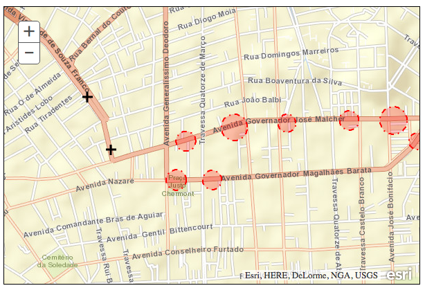

I need to add circles as avoid areas centred in a specific position. Instead of a point, an area must be set as a barrier.

The addBarrier() function uses the location of the objects called sensor.
So instead of a simple symbol STYLE_CROSS to represent a barrier, a circle with a custom radius must be used.
The circles need to be centred the same way the barriers is being placed, using the parameter position of the sensor object.
The radius of each circle is defined inside each sensor.

Pedro,
  I see you are still using legacy coding style (not good). Here is how you would use polygon barriers and use AMD style coding:

RobertScheitlin__GISP
MVP Emeritus
Pedro,

            var map, routeTask, routeParams, routes = [];
            var stopSymbol, barrierSymbol, routeSymbols;
            var mapOnClick_addStops_connect, mapOnClick_addBarriers_connect;
            var x = -48.48;
            var y = -1.45;
            map = new Map("map", {
                basemap: "streets",
                center: [x, y],
                zoom: 15
            routeTask = new RouteTask("https://route.arcgis.com/arcgis/rest/services/World/Route/NAServer/Route_World");
            routeParams = new RouteParameters();
            routeParams.stops = new FeatureSet();
            routeParams.polygonBarriers = new FeatureSet();
            routeParams.outSpatialReference = {
                "wkid": 102100
            routeTask.on("solve-complete", showRoute);
            routeTask.on("error", errorHandler);
            stopSymbol = new SimpleMarkerSymbol().setStyle(SimpleMarkerSymbol.STYLE_CROSS).setSize(15);
            stopSymbol.outline.setWidth(3);
            barrierSymbol = new SimpleMarkerSymbol().setStyle(SimpleMarkerSymbol.STYLE_X).setSize(10);
            barrierSymbol.outline.setWidth(3).setColor(new Color([255, 0, 0]));
            barrierSymbol2 = new SimpleFillSymbol(SimpleFillSymbol.STYLE_SOLID,
              new SimpleLineSymbol(SimpleLineSymbol.STYLE_DASHDOT,
              new Color([255,0,0]), 2),new Color([255,0,0,0.25]));
            routeSymbols = {
                "Route 1": new SimpleLineSymbol().setColor(new Color([0, 0, 255, 0.5])).setWidth(5),
                "Route 2": new SimpleLineSymbol().setColor(new Color([0, 255, 0, 0.5])).setWidth(5),
                "Route 3": new SimpleLineSymbol().setColor(new Color([255, 0, 255, 0.5])).setWidth(5)
            //button click event listeners can't be added directly in HTML when the code is wrapped in an AMD callback
            on(dom.byId("addStopsBtn"), "click", addStops);
            on(dom.byId("clearStopsBtn"), "click", clearStops);
            on(dom.byId("addBarriersBtn"), "click", addBarriers);
            on(dom.byId("clearBarriersBtn"), "click", clearBarriers);
            on(dom.byId("solveRoutesBtn"), "click", solveRoute);
            on(dom.byId("clearRoutesBtn"), "click", clearRoutes);
            function addBarriers() {
                removeEventHandlers();
                addBarrier();
            //Adds a barrier
            function addBarrier() {
                var idealCondition = 50;
                var eventsArray = [];
                for (var i = 0; i < sensors.length; i++) {
                  var sensorVal = sensors.contextElement;
                  var aircondition = parseFloat(sensorVal.attributes[0].value);
                  if(aircondition >= idealCondition){
                    var posArray = String(sensorVal.attributes[1].value).split(",");
                    var pnt = new Point(posArray[1], posArray[0], new SpatialReference(6864));
                    var mercPnt = webMercatorUtils.geographicToWebMercator(pnt);
                    var circleGeometry = new Circle(mercPnt, {"radius": aircondition});
                    console.info(circleGeometry);
                    routeParams.polygonBarriers.features.push(map.graphics.add(new Graphic(circleGeometry, barrierSymbol2)));

However, this error always happens in the first attempt to solve the route. The steps that ends in error are:
1- Add Barrier
2- Add Stops
3- Solve Routes
For this case, this solution is not working, giving the error below.
init.js:113 TypeError: Cannot read property 'join' of undefined(…) "TypeError: Cannot read property 'join' of undefined
    at errorHandler (http://localhost:8080/pollutionarea.html:236:78)
    at .<anonymous> (https://js.arcgis.com/3.17/init.js:644:365)
    at c [as onError] (https://js.arcgis.com/3.17/init.js:119:79)
    at _errorHandler (https://js.arcgis.com/3.17/init.js:1969:40)
    at https://js.arcgis.com/3.17/init.js:63:209
    at error (http://js.arcgis.com/3.17/esri/tasks/RouteTask.js:8:489)
    at https://js.arcgis.com/3.17/init.js:870:131
    at c (https://js.arcgis.com/3.17/init.js:103:393)
    at d (https://js.arcgis.com/3.17/init.js:103:182)
    at reject.errback (https://js.arcgis.com/3.17/init.js:105:163)"m @ init.js:113(anonymous function) @ init.js:114filter @ init.js:71h @ init.js:114
