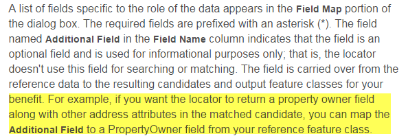

When creating an Address Locator it is possible to map "Additional Field" to a field in your reference feature class. I have no issue doing this but am unable to figure out how to access this information when using the Address Locator. The help shows:
ArcGIS Help (10.2, 10.2.1, and 10.2.2) ...
Once I have published my Address Locator to arcgis server, how can I get to the PropertyOwner information when I use this address locator in arcgis javascript? I am able to geocode address and reverse geocode locations in my map but want to access the additional information.

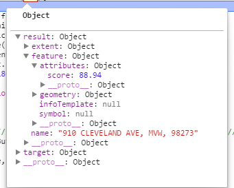

TimWitt2
MVP Alum
Sadly the javascript api only returns the following attributes.
