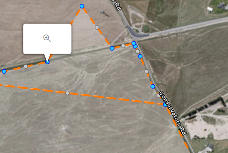

Hi
A default popup appear when i click on vertice of polygon. As i m also using markers with popup in my app, but they also appear on my vertices with default body.
The line in bold shows my popup, but it should not work for polygon vertices.

16 Replies
RobertScheitlin__GISP
MVP Emeritus
Well because you are using two SVMs then you need to check the state of both of them like I suggested last post.
rsharma
Sir
I am already checking the state for both of them, I don't know where i m getting wrong.
MVP Emeritus
Honestly I do not either. If you have vertices showing then one of the SVMs should be active, unless you are manually adding the vertices to some graphics layer.
rsharma
But i m using this condition, how can a popup appear , if they are active.
I am adding markers with popup on separate layers.
else if(sketchViewModel.state !== 'active'){
                  sketchViewModel.cancel();
                  //view.popup.open({features: [result.graphic], location: result.graphic.geometry});
                }  else if(markersketchViewModel.state!== 'active'){
                   markersketchViewModel.cancel();
MVP Emeritus
Rajni,
   I think I recommended before that you check the state of both SVMs at the same time not in separate else ifs.
}else if(markersketchViewModel.state!== 'active' && sketchViewModel.state !== 'active'){
  if(markersketchViewModel){
  if(sketchViewModel){
rsharma
Well your code blocked my markers also, so i did some minor editing, and now it works fine.
if( result.graphic.attributes &&
result.graphic.attributes.newDevelopment){
