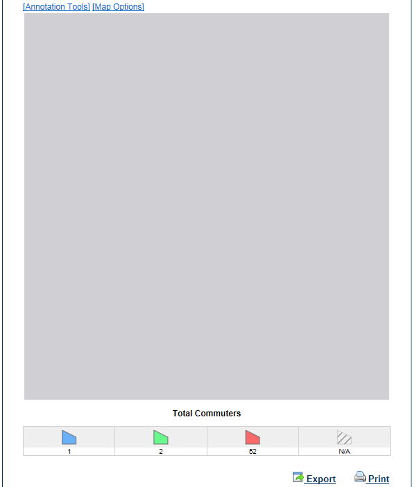

I am embedding a map within an iframe inside of a hidden container div; I've dealt with this bug since 3.8. Essentially, after page load, users can elect to toggle a div, which should render/hide the map. This works beautifully if the container is rendered to the dom and visible on the page on first load, but it chokes when the container is hidden:

This is where it chokes. "l" has font info, but font size is undefined. So, the call to getHeight() in "esri/symbols/TextSymbol" sends an undefined font size to normalizedLength() in "dojox/gfx/_base", which gives me "Unable to get property 'length' of undefined or null reference" in the console. All because the map container div is collapsed/hidden - I think the map is confused as it doesn't have a reference to size things appropriately.
I have been working around this by toggling the container on, then quickly collapsing the div after page load. It looks kludgy, but works well, although it gets complicated as there are maps throughout the application, and user settings are persisted.
