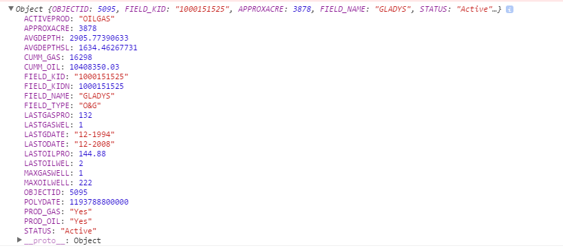

Here's a visual representation of this:
Some info on the attributes from the selection:
Is this the kind of info you need?
