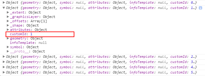

In Javascript you can just add your ID property to each graphic as you are adding them to your map:
        var id = 0;
        dojo.forEach(solveResult.serviceAreaPolygons, function(serviceArea){
          // Add a custom id property and value:
          serviceArea.customId = id;
          id += 1; // increment the ID value
          serviceArea.setSymbol(polygonSymbol);
          map.graphics.add(serviceArea);
If you log the results to the console you can see your new property values:
Just make sure not use existing object property names for your new property.

  /* var id = 0;
   console.log(serviceArea);
  // if (serviceArea.FacilityID = 2)
  // else {map.graphics.clear(serviceArea);}
