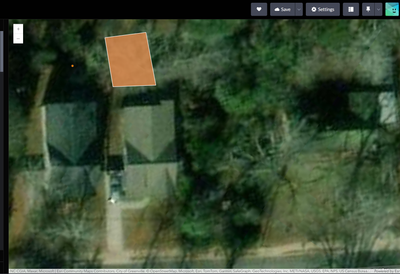

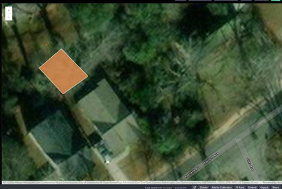

@JohnGrayson Here is the Codepen example(https://codepen.io/Andy0206/pen/mdYJBEX?editors=1000) in which I'm trying to rotate the map view to make the polygon 90 degrees for one of my requirements. But the angle is not coming right as the second screenshot
I have a polygon like this
and want to make the polygon to 90 degrees with it.
