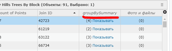

MaximSpikin1
Hi,
in ESRI sample FeatureTable - related records | ArcGIS API for JavaScript 3.22  field  "groupBySummary"
That name for this field?
How can i format it in "fieldInfos" or hide in "HiddenFields" properties?
for example, that I should write in the parameter "name" and so on.
fieldInfos: [
      name: 'groupBySummary',  - ???????????
      alias: 'groupBySummary_alias',
Thanks.

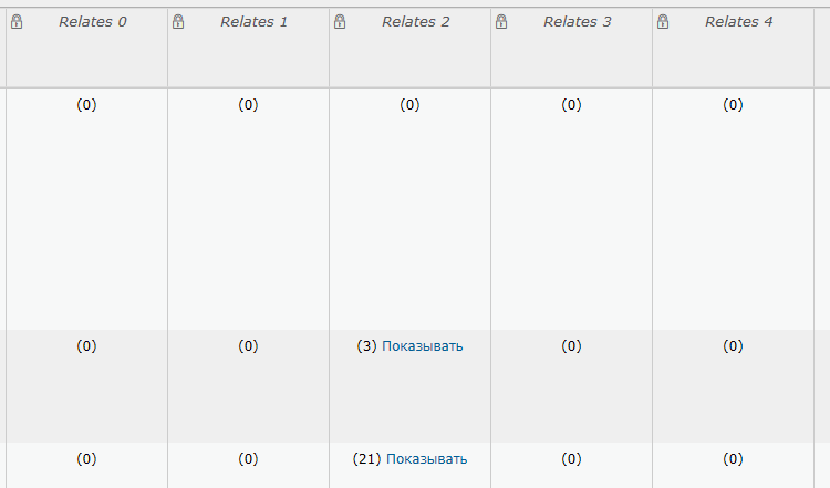

MaximSpikin1
Robert, thanks for response !
But how to turn off/on related field without setting the property "showRelatedRecords: false".
I have a few relations, some I need to turn off and some I need to turn on.
RobertScheitlin__GISP
MVP Emeritus
Maxim,
   Are you asking how to turn off certain fields in the related data table?
MaximSpikin1
Robert,
I have several related tables
for example, I need to turn off field Relates 0, Relates 1, Relates 4
MVP Emeritus
Maxim,
  OK,
  here is the code for that:
          myFeatureTable.on("load", function(evt){
            //toggle the 9 column to hidden
            myFeatureTable.grid.toggleColumnHiddenState(9, true);
            var rFldTtile = dojoQuery(".esri-feature-table-column-header-title.esri-feature-table-related-records-title").forEach(function(item, index){
              item.innerHTML = "Relate " + index.toString();
MaximSpikin1
Robert,
many thanks,
and the last question - is how to set width a columns ?
MVP Emeritus
Maxim,
  That is as simple as:
myFeatureTable.grid.resizeColumnWidth(8, 60);
Don't forget to mark this question as answered by clicking on the "Mark Correct" link on the reply that answered your question.
