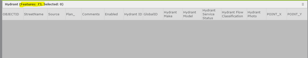

When using standard javascript and standard examples of AMD, my feature table loads just fine, but when using this inside typescript the rows just never load. It also never makes a call to retrieve the data. I also added an on error event as referenced in the code below and it never gets thrown. I also have many other controls that run just fine and I receive no javascript errors. What can I do diagnose the issue further?
