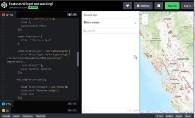

For some feature layers,  when you click on a feature, you expect the popup to be displayed on the features widget panel, but it just opens and closes the widget immediately!
https://codepen.io/lkoumis1/pen/poXqjxR
It's similar to the example posted here. The only difference is that I added a feature Layer instead of using a webmap.
https://developers.arcgis.com/javascript/latest/sample-code/sandbox/?sample=widgets-features

The map layer that you're providing doesn't have a popupTemplate defined, whereas the web map does. Once you add a template (like in this sample), the Features widget works as expected.
        const template = {
          title: 'This is a test'
        const featureLayer = new FeatureLayer({
          url: "https://gis.cnra.ca.gov/arcgis/rest/services/Boundaries/CCED_AccessType/MapServer/0",
           outFields:['*'],
           popupTemplate: template

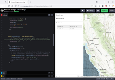

I substituted another layer and the code would work sometimes, returning content in the Features widget, but it wasn't consistent. Sometimes it would throw the error "popupTemplate is null". Are you getting that in your console?
I changed the view.when to featureLayer.when and that seemed be more consistent with a layer that takes a while to load.
I also tried using an await function with the FeatureLayerView and that seemed pretty consistent also.
view.when(() =>{
  (async () => {
    const layerView = await view.whenLayerView(featureLayer);
    await reactiveUtils.whenOnce(() => !layerView.updating);
    const popupTemplate = featureLayer.createPopupTemplate();
    popupTemplate.title = 'This is a test';
    featureLayer.popupTemplate = popupTemplate;
