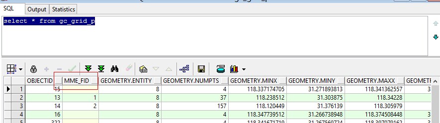

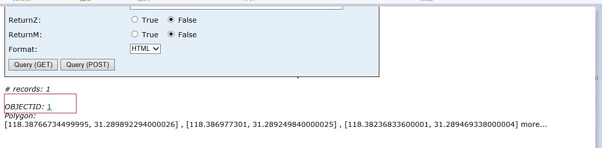

     Q:  I publish a map layer by arcMap, this layer's data construct by two database's tables join in. A table is graphic table (picture aaa), B table is attribute table,the two   tables join by mme_fid,(A and B both have mme_fid).but the mme_fid not in published feature layer (the layer only can see the key field objectId ,not see the mme_fid (picture bbb)). when I create  a graphic  to graphic table A ,the mme_fid not saved. I don't know why?
picture  aaa:
picture bbb:

I don't think you can edit a Joined table. You can join and view a Map Service, but a feature layer won't display a joined table. You will likely have to relate the tables instead so that you can edit them.
