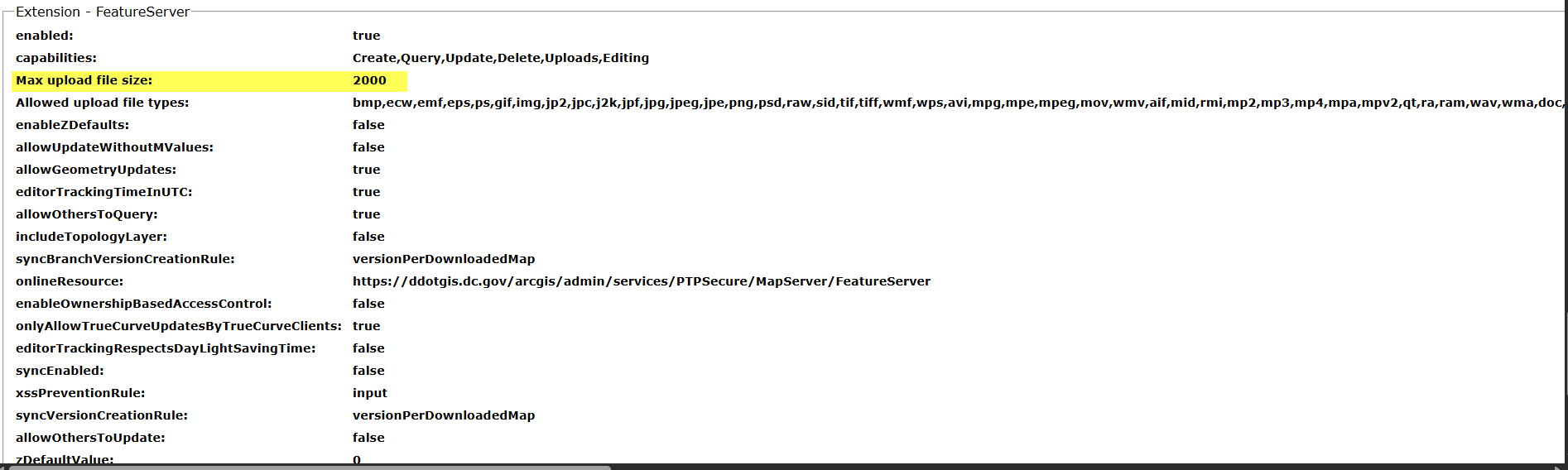

I have ArcGIS Server 11.5 with the following configuration:

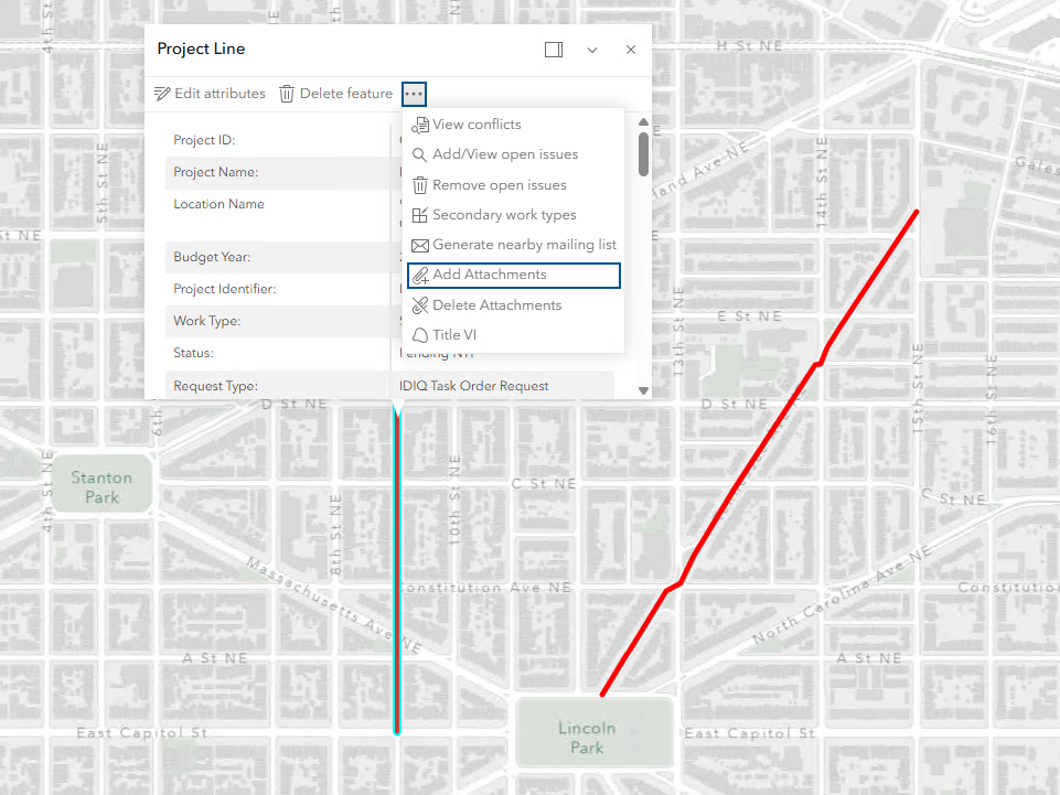

I can upload feature attachments (up to 20MB) using the following function called popup action.
The function is:

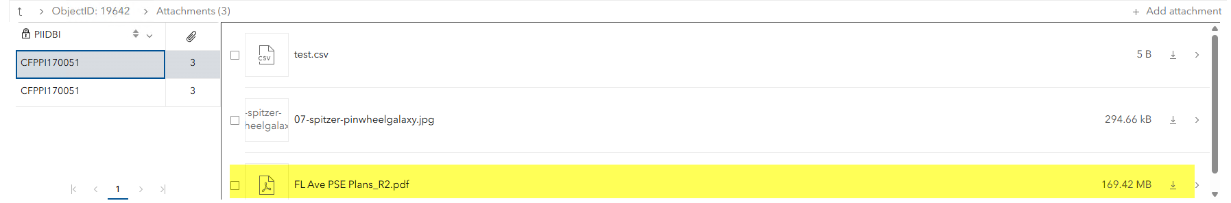

I tried for file size of 170MB and fails with 500 error code.
Interestingly, I can upload this using fearureTable add attachment.
I appreciate for any work aroun
MKY
Error in my IIS setup of maxAllowedContentLength. increased to 2GB and works fine
MKY
