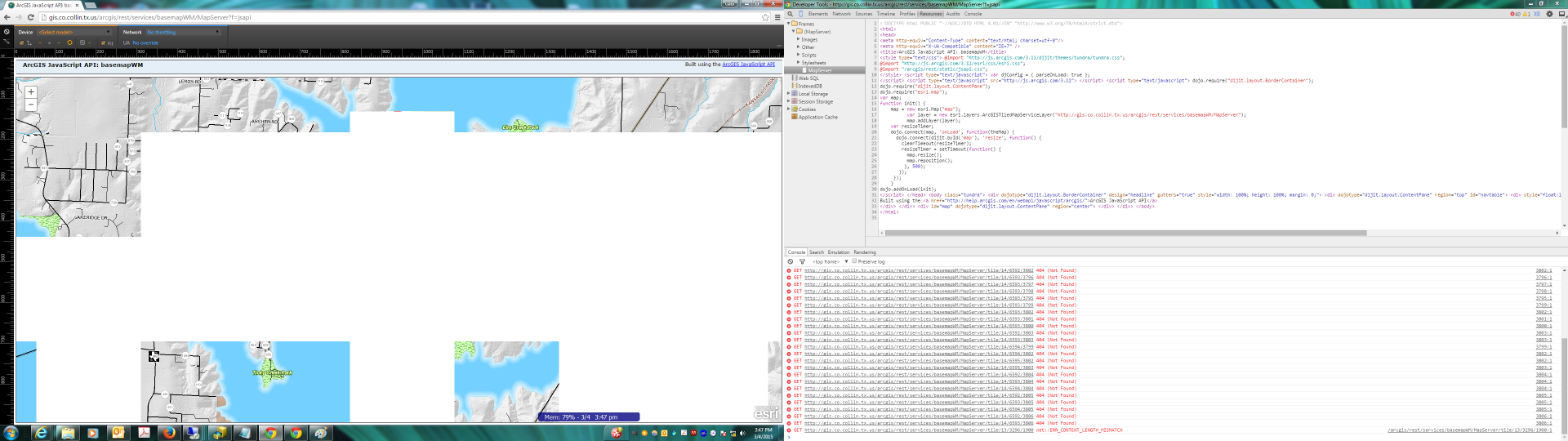

This is the error that I get on my web mapping app
Failed to load resource: the server responded with a status of 404 (Not Found)
http://gis.collincountytx.gov/electionpollingplace/
This is a web server that is hosting the app inside the DMZ requesting the ArcGIS Server (two of them behind a load balance F5) tiles from a different location/server inside the network
...and this is the ArcGIS Server that is hosting the maps
ArcGIS JavaScript API: basemapWM
Thank you
Gabi Voicu
OwenEarley
There appears to be an issue with the map tile creation process. As soon as the map zooms to level 13 there are missing tiles. I would look into recreating the tiles with Manage Map Server Cache Tiles tool and use the RECREATE_EMPTY_TILES update mode.
